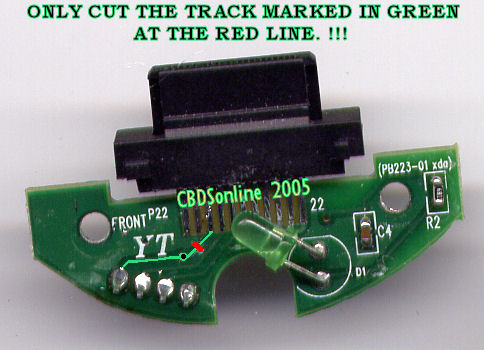

This may be the solution to all XDAii users with active sync problems.
Please let me test this out for a few days before anyone tries it out and poss kills either there xdaii or kills the holux cr100.
Having played with my xdaii for a while building usb chargers and moding ipaq hardware to work with an xdaii i read and hangout on XDA forums.
I have the pinout diag for the xdaii connector (and its the same as xda) apart from speaker pinout. When pin 6 (serial DCD) is pulled up to 5 or 6v it auto powers the xda and trigers activesync.
I cracked open my (brand new just arrived today) CR100 and examined the connector. Pin 6 is linked to pin 20, 21 and 22 (power +) so it pulls pin6 to 5v and auto powers the xdaii kicking Activesync in as soon as power is supplied to the CR100.
I took the pcb and made a small cut in the track that goes to pin 6 just above the small via that connects the two sides of the pcb track to pin 20,21 and 22. I rebuilt the CR100 and plugged my 12v psu into the unit.
green power light comes on and orange gps light comes on.. (proves the CR100 has power) i plugged my xdaii in and it did not auto power. When i powerd the xdaii up it just sat nice on the main screen and NO sign of Activesync.
Its sitting here in my loft no where near the window on 6 locked sats quiet happy.
Xdaii is running TomTom 5.10 and TomTom Cable GPS is selected
Please give me a few days to fully test and i will report back if all is good and will attach an image of the connector and where to make the modification. Laughing

PostPosted: Thu Aug 18, 2005 11:38 am    Post subject: Cutting Pin 6 on the CR100 Reply with quote
Hi,
Yes, the solution to the activesync problem with the XDA is to cut pin6 in the CR100 connector. We have tested this with a number of units in the field and there have been no problems with either the XDA or the CR100 after having done this modification.
We are trying to get this done at manufacture so that the problem doesn't arise.

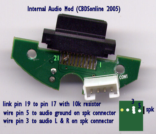

Holux UK Tech might also want to look into removing pin 5 from ground as this is an analogue audio ground not a system ground and might help some of the feedback comming through the cr100 speakers when the phone is active
It is also possible to hardwire the audio direct from the adxii connector to the speaker connector in the cr100 and this removes the need to use the external audio cable. The only drawback is that the when the phone rings it hangs up straight away. personally i dont use the phone side of the xdaii so i dont care but i am looking into it

PostPosted: Fri Aug 19, 2005 8:23 pm    Post subject: Reply with quote
The answer to the phone auto hangup when someone calls it when you do the internal audio mod is that you need pin2 to be cut from ground.
Pin 2 is on the front beside the led and is attached to ground down the side of the connection and at the bottom so it should be attached to ground in 2 places.
Carefull use of a sharp scalpell / craft knife and testing with a multimeter should be all it takes to disconnect pin 2.
I have tried it and is working good. Only problem remains is you need to remove the XDAii from the cr100 to answer it as the cr100 aint got any internal mic.
Maybe Holux can look into adding a mic and the wires for internal speaker and that would make the cr100 the total answer for handsfree and satnav
Most XDA's and Ipaq's have audio on the bottom connector and internal audio would make a better selling point that having to attach a cable every time you want to use it. Adding 3 wires to each board and modding the connector pcb would be easy.
