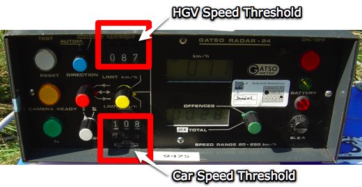

GATSO's have long since had the ability to trigger at two different speeds, for HGV's and other road users.
I suspect it may well be true of other devices. If you look at the image below you can just about discern the HGV icon above 087 at the top which matches the Car icon at the bottom.
That shows the settings for the different speed thresholds.

I'm sure Andy posted a photo of the control panel inside a GATSO the last time this came up...
ETA: It's here
PostPosted: Sun Jul 05, 2009 9:34 am    Post subject: Reply with quote
Andy's pics are better than mine Embarassed
PostPosted: Sun Jul 05, 2009 9:35 am    Post subject: Reply with quote
There are a few with height finder kit added to the camera, if a tall vehicle goes through it uses the lower limit - not always fool proof though as coaches can set them off at the lower speed even though they should be using the higher speed rating - Mike
