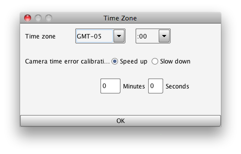

Thanks for a thorough review. My wife and I have been geotagging photos for about 2.5 years with various devices, replacing one with another because the old one dies. We were recently given the Columbus v900 and have been logging data the past couple of days and hoping to actually geotag today with the Columbus software. I have two questions I hope you can shed some light on:
1) In the Columbus software, is there a way to set the photo-matching tolerance/threshold? For example, can you set the matching threshold so that photos are embedded with GPS data, even if the nearest time track is 5 minutes, 15 minutes, 30 minutes, etc. away? With 3rd party geotagging software, we can set this easily. Was hoping the Columbus software might allow it.
2) We are noticing that the device is consistently taking tracks in groups of maximum three continuous tracks spaced one second apart, then skipping an amount of time. This has been consistent across days of data, even when we believe we should have a reliable signal. The following timestamps for a sequence of tracks is typical:

lbendlin
Joined: 02/11/2002 22:41:59
Posts: 11878
Location: Massachusetts, USA
PostPosted: Mon Sep 28, 2009 1:35 am    Post subject: Reply with quote
1) is mentioned in the review
2) Are you sure you didn't accidentally enable "Spy" mode ?

dannoll
Joined: Sep 28, 2009
PostPosted: Tue Sep 29, 2009 6:44 pm    Post subject: Reply with quote
Hi Lutz,
Thanks for the quick reply.
1) I think I'm asking something a little different. Unless, if I understand you correctly, that the Columbus software only allows time correction in one direction. That is, you can tell it that the camera is slow by X minutes, or fast by X minutes. But you can't tell the software "match the photo to a GPS coordinate within 15 minutes (before or after) when the photo was taken". If the Columbus software can do that, it's not clear to me from the user guide or this tutorial how it could.
2) The device was not in spy mode. If it were, I would expect the groupings to be exactly 1 minute apart (the current spy mode configuration setting).
Thanks,
Dan
lbendlin
Posts: 11878
PostPosted: Tue Sep 29, 2009 8:58 pm    Post subject: Reply with quote
ah, but spy mode works differently. It wakes up, tries to take positions (up to eight) and then goes to sleep again. It can take any amount of time to try and get a fix, and will only start the counter again after it succeeded. So what you got is a mix of successful and unsuccessful attempts, methinks.
as for 1) - Try it out, maybe the software has an internal wobbly as long as your times from the camera and the GPS are close enough.
