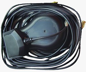

TomTom have announced that there now will be an antenna available for TomTom GO.
The Antenna will start shipping end of July/August for approx 70 euro's. Currently there is no socket available on the GO to plug an external antenna into so the new antenna will come with a new base mount.

I bought one of these as mine was having difficulty locking onto any satellites and when it did it kept losing them, within a minute after connecting the external antenna it locked onto several and has maintained this ever since, I am now very pleased with this device but before buying the external antenna I had thought of getting rid as it was hopeless as I was still reliant on paper maps. Another thing I discovered was that if you turn the screen slightly up or down whilst it’s in the base mount so that you are not looking at it directly, it cuts out the reflection on the screen and it’s much easer to see.

PostPosted: Sun Aug 15, 2004 7:48 am    Post subject: Reply with quote
Which car do you have ? I suspect that it has an athermic windscreen installed.

It's a Renault Scenic, 02 reg. I've not tried it in any other car yet but I know it works ok out of the car so I suspect you’re right in what you say. Prior to this I had tomtom on a pda working on Bluetooth without any problems so I'm not sure why the tomtom go has. I still prefer the 'go' as the sound, details on the map and ease of setting up are much better. I understand that there is a professional kit that can be fitted so it mutes the radio and supplies power, when I change the car I may try this out but as that won't be until next year till then this will do for me.
PostPosted: Sun Aug 15, 2004 9:01 am    Post subject: Reply with quote
That explains it, you can virtually guarantee that ost Renault's, Peugeot's and Citreon's have athermic windscreens fitted.
Regarding the Bluetooth receiver, on athermic windscreens there is usually a small gap around the windscreen on the glass that isn't athermically treated and it maybe that the Bluetooth receiver was closer to the windscreen and was able to pickup GPS signals better, or it may have been that it had a much higher gain on the antenna.
You also usually find that the corners of the windscreen aren't athermically treated and also in most cars there's a section behind the rear view mirror that is used in some European countries for a sensor for toll booths and this area isn't athermically treated.

Thanks for the information, the windscreen does have a a black dotted area all around the edges and when I used the pda the gps unit was closer to the bottom of the windscreen. If this is the case do you think I could mount the external antenna inside the car at the back of the car as at the moment I've got it on the roof, which is where it is all the time and I have concerns that some idiot might try ripping it off
PostPosted: Sun Aug 15, 2004 7:24 pm    Post subject: Reply with quote
Yeah it should work around those edges of the windscreen. Some GPS antennas may work better than others, so there's no guarantee, but usually these areas don't have any athermic protection, so give it a try.

Tried it today and it works just as well as if it were positioned outside of the car, I would recommend this to anyone with the same problem.
