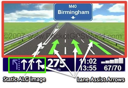

That's a good question, this is ALG:
It's important to realise that the image is STATIC and replaces the moving map. It pops up as you approach a junction that has ALG data, the arrows flash and the data at the bottom continues to update. As you pass the junction the moving map returns or you can tape the screen at any time to return to the map.

I have never had the static picture with the green arrows and the sign above.Just the small arrows bottom left,even though i do quite few motorway miles.Perhaps its as Mikealder says only 10% of junctions are covered.
