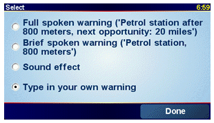

PostPosted: Sun Oct 15, 2006 11:55 am    Post subject: with text to speech? Reply with quote
Is there anything similar one can do to use text to speech instead? (on a 910)
annoyingly, their speed camera plus service doesn't allow selecting sounds (it's not configureable), and they don't turn up in the poi list, so I guess something similar could be done. I wish it could just synthesize a text.
PostPosted: Sun Oct 15, 2006 12:13 pm    Post subject: Re: with text to speech? Reply with quote
If you use a third-party camera database (like the one from here), you CAN use the Text to Speech to create yout own alerts
Instructions HERE
(Note that they will only work if you are also using a TTS voice for the navigation prompts)

Yes, I've seen that, as I have another free database installed in the past.
I just registered to TT's database because of the realtime updates feature.
Right now I'm digging for what changes when I set that option for other POIS. If I could figure out where and in what format the data is stored... I'm expecting the file to be the map .cfg file, which I cannot tell what format is being used to store in it.
Yes, it seems the TTS warnings are stored at the end of the MapSettings.cfg file. Unfortunately the formatting is a bit weird, so I'm not too sure how it refers to the poi file (yet)
